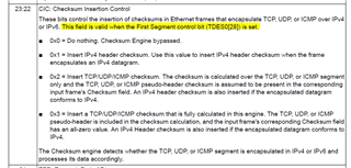

  • Hi Sung-hyun,
     I think I understand what you are doing and I agree with it. In the TivaWare driver, the CIC field which is the DES0_TX_CTRL_IP_ALL_CKHSUMS flag is written to all descriptors regardless if the descriptor is the start of packet or not. However, per the datasheet the CIC is only valid when the descriptor is the start of the packet. You change the code so that DES0_TX_CTRL_IP_ALL_CKHSUMS is only applied to the start of packet when DES0_TX_CTRL_FIRST_SEG is set. I take it that with the modification, you no longer see any data corruption. Is that a correct understanding? Once again, thank you for finding the issue and I will bookmark this post for future reference in case others having the same issue.
    CIC: Checksum Insertion Control
    These bits control the insertion of checksums in Ethernet frames that encapsulate TCP, UDP, or ICMP over IPv4
    or IPv6. This field is valid when the First Segment control bit (TDES0[28]) is set.
    ■ 0x0 = Do nothing. Checksum Engine bypassed.
    ■ 0x1 = Insert IPv4 header checksum. Use this value to insert IPv4 header checksum when the frame
    encapsulates an IPv4 datagram.
    ■ 0x2 = Insert TCP/UDP/ICMP checksum. The checksum is calculated over the TCP, UDP, or ICMP segment
    only and the TCP, UDP, or ICMP pseudo-header checksum is assumed to be present in the corresponding
    input frame's Checksum field. An IPv4 header checksum is also inserted if the encapsulated datagram
    conforms to IPv4.
    ■ 0x3 = Insert a TCP/UDP/ICMP checksum that is fully calculated in this engine. The TCP, UDP, or ICMP
    pseudo-header is included in the checksum calculation, and the input frame's corresponding Checksum field
    has an all-zero value. An IPv4 Header checksum is also inserted if the encapsulated datagram conforms to
    IPv4.
    The Checksum engine detects whether the TCP, UDP, or ICMP segment is encapsulated in IPv4 or IPv6 and
    processes its data accordingly.
