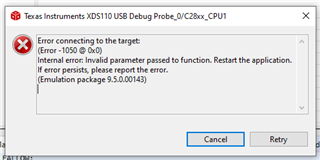

I bought a new XDS110 emulator and once connected to the PC on which I am using Code Composer Studio 10.4.0.00006 it asked me to update the firmware.
After software update, trying to launch debug I get this message
The old emulator updated with the same firmware version works fine.
I have tried with a second XDS110 but the result is the same error.
What is really even stranger is that the both new emulators connected to another PC work correctly.
What can I do ?

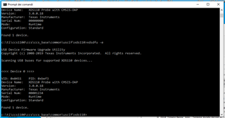

    Can you advise on the latest version of FW on the bad setup in the CCS 11 directory above?
    Can you also run the cmd line code: C:\ti\ccs1040\ccs\base\common\uscif\xds110>xdsdfu -e and post back the output of the command window here?
    Matthew
  • This is what I have in CCS 10.4 with good emulator
    This is what I have in CCS 11 with good emulator
    This is what I have in CCS 11 with bad emulator

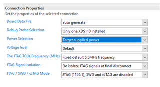

    Below results of Connection Test with different configuration
    PC BAD - XDS100 OK

    Now I'm receiving this error message

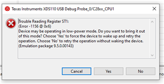

    2)For the error 1156, this indicates a low power state.  Can you put a meter or scope on the PD pin of the JTAG (pin 5) on the different boards/emulators and let me know what we measure?  This signal should be connected to the VDDIO plane of the PCB.
    Matthew
  • HW1 and HW2 have the same MCU and JTAG layout is very similar.
    On all the situation (different PC vs different emulators) the value on PD is always 3.290 V.
    With bad emulators and bad PC the error message is not always 1156, but different I receive this morning 1135

  • I tried and in this case on PC1 I received always error -1156
    The voltage value on PD is correct.

  • This is the setting I have
