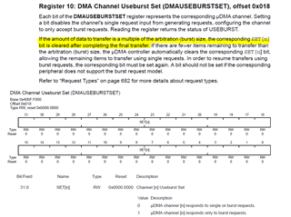

TM4C1294NCPDT: How to clear UARTDMA finished interrupt properly?
Part Number: TM4C1294NCPDT
I used Mr. Tsai's sample program to continue to work on UART uDMA (I modified it to use K0/1 instead, and baud rate). It works "fine", I can see data streaming out of TiVa1294 continuously.
Now, I want to just send out ONE burst of DMA, so I remove the codes to restart another DMA transfer inside UART4IntHandler. but UART4IntHandler is kept being called, it is like the interrupt flag could not be clear. So I add ROM_UARTDMADisable(UART4_BASE, UART_DMA_TX); to UART4IntHandler. This time the ISR is called twice before it stops. Is this the correct order work with uDMA on UART?
The final codes is attached below

    // Put the attributes in a known state for the uDMA UART4TX channel.  These
    // should already be disabled by default.
    uDMAChannelAssign(UDMA_CH19_UART4TX);
    ROM_uDMAChannelAttributeDisable(UDMA_CH19_UART4TX,
                                    UDMA_ATTR_ALTSELECT |
                                    UDMA_ATTR_HIGH_PRIORITY |
                                    UDMA_ATTR_REQMASK);
    // Set the USEBURST attribute for the uDMA UART TX channel.  This will
    // force the controller to always use a burst when transferring data from
    // the TX buffer to the UART.  This is somewhat more efficient bus usage
    // than the default which allows single or burst transfers.
    ROM_uDMAChannelAttributeEnable(UDMA_CH19_UART4TX, UDMA_ATTR_USEBURST);
    // Configure the control parameters for the UART TX.  The uDMA UART TX
    // channel is used to transfer a block of data from a buffer to the UART.
    // The data size is 8 bits.  The source address increment is 8-bit bytes
    // since the data is coming from a buffer.  The destination increment is
    // none since the data is to be written to the UART data register.  The
    // arbitration size is set to 4, which matches the UART TX FIFO trigger
    // threshold.
    ROM_uDMAChannelControlSet(UDMA_CH19_UART4TX | UDMA_PRI_SELECT,
                              UDMA_SIZE_8 | UDMA_SRC_INC_8 |
                              UDMA_DST_INC_NONE |
                              UDMA_ARB_4);
