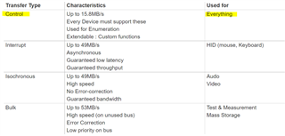

Hello, I need to create a USB vendor specific device communicating only via a control endpoint 0. No additional endpoints should be defined and used. Is this possible? How can I handle callbacks?
      Yes, In theory, I think it is possible. However, we don't have an example that setup only for control transfers with endpoint 0. Per USB standard, all USB devices must at least support control transfers using endpoint 0. TivaWare examples are written for various USB classes such as bulk, HID, CDC. These class dependent examples will make use of other type of transfers like interrupt and bulk using more endpoints in addition to the control transfers. I will suggest you refer to TivaWare USB examples and perhaps modify them to remove the things that are not needed for your application. You can find USB examples in directory C:\ti\TivaWare_C_Series-2.2.0.295\examples\boards\ek-tm4c123gxl
    yes, that is exactly what I did. I started with generic bulk device example which uses Vendor Specific Device class and 2 additional endpoints, which should of course be removed. According to the USB specification, the control transfer is initiated by a host setup transaction, followed by several data transactions and ended by a status transaction. The data transaction can transfer even a vendor specific data. How are this data transmitted and received by the device, which callbacks are called, ... when no additional endpoints are defined.

    With the above said, the TivaWare USB library only handles the standard host requests like GET_DESCRIPTOR, GET_STATUS and etc using endpoint0 during enumeration.  In another word, it is not for transferring user/functional data. At least that is not how USB library is designed and I don't see the hooks to extend for custom functions. As you can see from usb_dev_bulk.c example, the functional data transfer will use other endpoints that will be handled in class specific requests. I'm not sure what your application is. You maybe better off to use the usb_dev_bulk.c transfer. If you still want to only do transfers on endpoint0 using control transfers, I think you will need to customize the USB library and that will be on your own. Sorry.
  • Hi, this is exactly what I thought and I was worried about. Thank you for your help.
