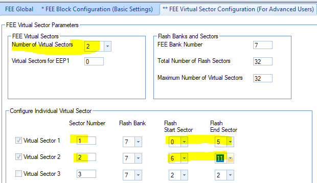

The bank 7 (EEPROM) consists of 32 physical flash sectors. One virtual sector can contain one or more contiguous flash physical sectors. A minimum of 2 virtual sectors are required. For example:
The size of each virtual sector (VS) is 24Kbytes. The header of virtual sector is 32-bytes, and each data block includes a header of 24 bytes. You are correct, only 24KB-32-24*#ofBlock can be used for payload.
