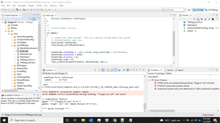

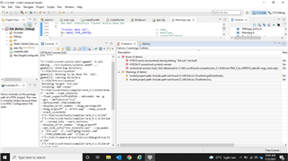

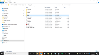

    Before renaming the 'src' directory it's having a ".exclude". file. As per your suggestion renamed the src directory by test refer(Image-2). All custom files moved into the test folder. After that opend test folder manually it's having a ".exclude" file refer(Image-3).
    After compilation automatically src folder created and it's having a ".exclude" file (Image-1). As per above info ".exclude" file stoping the copilation. Manually removed the ".exclude" file in test folder and compiled and got an error like illegal character (Image-4).
    Conclusion: Renamed src folder with test and removed ".exclude" file in test folder manually and compiled, getting an error like illegal charatcer refer image-4.
    1) Image-1
    .After copilation automatically src file created
    2) Image-2
    3) Image-3
    4) Image-4
    Krishna

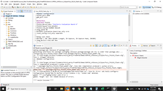

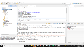

  • Hi Ki,
    Created a new project (Test 450) and after that added empty folder like "source_files" copied all custom files into the source_files folder and updated build settings. After compilation getting an error like below.

  • Manually removed the ".exclude" file in test folder and compiled and got an error like illegal character (Image-4).
    The error is coming the fury_ft2322_flash.cfg file, which looks to be a configuration file for the OpenOCD debugger.
    The CCS build system treats a .cfg file extension as a SYS/BIOS configuration file which results in the error when it tries to compile the OpenOCD configuration file as it was is a SYS/BIOS configuration file.
    If you don't need the file either delete it, change the file extension or right-click it in the CCS Project Explorer and select "Exclude From Build".

    'Building file: ../source_files/TivaWare/third_party/FreeRTOS/Demo/CORTEX_LM3Sxxxx_Eclipse/fury_ft2232.cfg'
    'Invoking: XDCtools'
    "C:/ti6/xdctools_3_30_03_47_core/xs" --xdcpath="C:/ti6/bios_6_40_01_15/packages;C:/ti6/ccsv6/ccs_base;" xdc.tools.configuro -o configPkg -t ti.targets.arm.elf.M4F -p ti.platforms.tiva:TM4C129XNCZAD -r release -c "C:/ti6/ccsv6/tools/compiler/arm_5.1.6" --compileOptions "-g --optimize_with_debug" "../source_files/TivaWare/third_party/FreeRTOS/Demo/CORTEX_LM3Sxxxx_Eclipse/fury_ft2232.cfg"
    making package.mak (because of package.bld) ...
    generating interfaces for package configPkg (because package/package.xdc.inc is older than package.xdc) ...
    configuring fury_ft2232.xem4f from package/cfg/fury_ft2232_pem4f.cfg ...
    js: "C:/ti6/Test450/source_files/TivaWare/third_party/FreeRTOS/Demo/CORTEX_LM3Sxxxx_Eclipse/fury_ft2232.cfg", line 1: illegal character
    js: #daemon configuration
    js: ^
    js: "C:/ti6/Test450/source_files/TivaWare/third_party/FreeRTOS/Demo/CORTEX_LM3Sxxxx_Eclipse/fury_ft2232.cfg", line 1: Compilation produced 1 syntax errors.
    js: "./package/cfg/fury_ft2232_pem4f.cfg", line 184: Compilation produced 1 syntax errors. (C:/ti6/Test450/source_files/TivaWare/third_party/FreeRTOS/Demo/CORTEX_LM3Sxxxx_Eclipse/fury_ft2232.cfg#1)
    gmake.exe: *** [package/cfg/fury_ft2232_pem4f.xdl] Error 1
    js: "C:/ti6/xdctools_3_30_03_47_core/packages/xdc/tools/Cmdr.xs", line 51: Error: xdc.tools.configuro: configuration failed due to earlier errors (status = 2); 'linker.cmd' deleted.
    gmake: *** [configPkg/linker.cmd] Error 1
    gmake: Target `all' not remade because of errors.
    **** Build Finished ****

  • After excluding the "fury_ft2322_flash.cfg" fle from build, getting an error like below.
    The fault has moved to the C:/ti6/Test450/source_files/TivaWare/third_party/FreeRTOS/Demo/CORTEX_LM3Sxxxx_Eclipse/fury_ft2232.cfg, which is another .cfg file which is a configuration file for the OpenOCD debugger rather than a SYS/BIOS configuration file.
    I don't know how the project has been setup, but it seems wrong for a SYS/BIOS based project to be including files within a FreeRTOS demo project.
    Are are able to attach the complete project, or failing that just the .ccsproject , .cproject and .project files?
