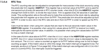

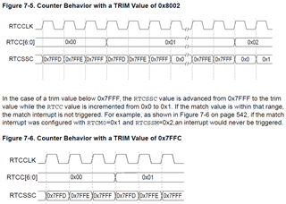

  • Hi Rajesh,
     Thank you for providing data points from the development board. Your description tells me that the RTC is running too fast in the development board and too slow in your own board. Please refer to the datasheet on how to use the RTC trim to compensate for too-fast or too-slow RTC clock. This below post also has the same discussion. https://e2e.ti.com/support/microcontrollers/arm-based-microcontrollers-group/arm-based-microcontrollers/f/arm-based-microcontrollers-forum/728026/tm4c123gh6pz-using-the-rtc-with-the-trim-register?tisearch=e2e-sitesearch&keymatch=RTC%2520trim#
      I will suggest you start perhaps with 1minute of hibernate time and see how much to compensate using trim. Once you get the 1 minute to correctly compensate then increase the hibernation time to longer duration like 10min. Don't start with hibernation time like 12 hours as you need to wait too long for each experiment.
