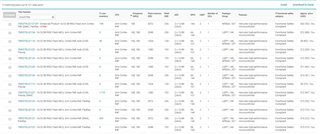

We are currently considering the TMS570LS3137-EP, as well as parts from the TMS570L series (listed here)
I was wondering if you could provide me the following information:
  • What is the supply outlook for the TMS570LS3137-EP and TMS570L series over the time frames describes above? Are there parts available that meet the requirements I've described above? If so, which part numbers? I saw on TI's website that the stock for the first part I mentioned looks alright (in the medium-term but not for mass production), but there is limited stock for the other TMS570L series parts that I filtered with the product selector.
