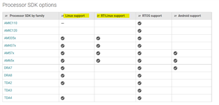

I have not seen anyone running linux on TM4C129 MCU. I suppose Linux kernel requires quite some memory to support. I don't think TM4C129 will be a good platform for running Linux in my opinion. You might want to check https://www.ti.com/design-resources/embedded-development/arm-based-processors.html for TI processors supporting Linux.
