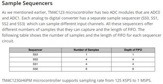

   I am using TM4C1294KCPDT controller . I want to intialised two analog pins , in this i am not aware of ADC Sample Sequencers . Any body can explain this with example?
what its means number of sample and Depth of FIFO ? how i can use this in configuration.
Thanks in advance.
    The number of samples would indicate how many samples are gathered before an interrupt is triggered to indicate that sampling is completed. The FIFO depth indicates the maximum number of samples that can be stored before the FIFO is full. Once the FIFO is full, future writes will not occur until the FIFO is emptied but an overflow flag will be triggered to indicate the ADC was not serviced quick enough and sample data was lost as a result.

    Sequencer-0 means steps should be 8 only i think so .... but here they mentiond variously ... above configurations are correct ?

    Regarding the steps themselves, the step value determines the order in which the samples are captured by the ADC when the trigger occurs. So you can set any value that is eligible for the sequence. Additionally, if you can have multiple steps for a sequence, you can select different channels to be used for each step. For Sequence 0 which has 8 samples available, you can select to sample from up to 8 different inputs before triggering the interrupt.
    What the code you posted is doing that for four inputs where the first sample is done on CH0 for Step 0, the second sample is on CH4 for Step 1, the third on CH8 for Step 2, and the fourth sample is on CH9 which is Step 3 and Step 3 is the last step so the interrupt would trigger after that sample is processed.
    Now the ADC FIFO which is 4 values deep will have the 4 samples in it. As it is a FIFO, reading it out will get the values in the order they were samples which is CH0, CH4, CH8, and CH9.
