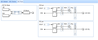

  • Thank you for the answer.
    The pull-ups were set via HALCoGen for the SDA and SCL line (see screenshot). Unfortunately the problem remains as described above. Would you have another suggestion?
  • Hi Thilo,
    The internal pullups are too weak to be used for I2C. They're just strong enough to keep the pins from floating.  You have to provide external pull-up to I2C signals.
