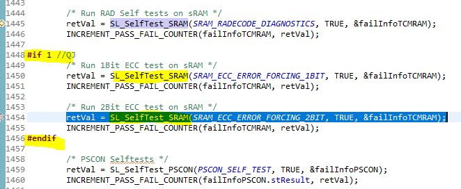

Used code from SafeTI Diagnostics Library test SL_SelfTest_SRAM and tried to integrate with our project.

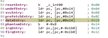

When executed below line of code, it crashes and jump to location as shown below.

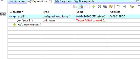

Please find below snap shot when it tried to read from 0x08416260, it says fail to read from this location.
Could you please help, if i am missing anything. Also tried to execute this before STC self-test. Still same issue.
sl_l2ramwREG->DIAG_ECC = (*eccB1) ^ L2RAM_SYN_2BIT_DATA_ECC;

    1. retVal = SL_SelfTest_SRAM(SRAM_ECC_ERROR_FORCING_1BIT, TRUE, &failInfoTCMRAM);
    ESMSR2 = 0x80   --> ESM 2.7 = 1
    DRSE=1, Diagnostic Read Single-bit Error.
    and DWSE=1, Diagnostic Write Single-bit Error
    2. retVal = SL_SelfTest_SRAM(SRAM_ECC_ERROR_FORCING_2BIT, TRUE, &failInfoTCMRAM);
    DRDE=1, and DWDE=1  (RAMERRSTATUS register)

    And just want to know if eccB1 value is 0x08416260 in your code also and you are able to read the location.

  • Hi Wang,
    I observed when _mpuInit_() function is called before L2RAM test, getting data abort error as mentioned, may be it protects memory. When i disabled mpu by calling _mpuDisable_ function before L2RAM ECC test, it works fine for both single bit and double bit. Thank you so much for all your help.
