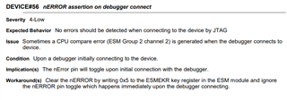

Part Number: RM57L843
Please clarify the workaround for Errata Device#56.
My customer observes CPU compare error a lot under debug.
esm1_stat2 : 00000004
According to errata document, just writing 0x5 to ESMEKR and ignore nERROR pin is enough.
We do not need to take other actions such as clearing ESMSR2?
