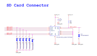

  • Hi Li,
    I got a AM243x LP and a booster pack for SD card. When I plug in the booster pack for SD card, the AM243x LP can boot from the SD card and the mmcsd_file_io_am243x-evm_r5fss0-0_nortos_ti-arm-clang runs fine too. So my guess is that the connection between the SD connector and the SD slot is the root cause of the problem. Attached please find the schematics of our SD card booster pack.
    AM243x_LP_TEST_JIG_SCH_REVA.pdf
    Ming

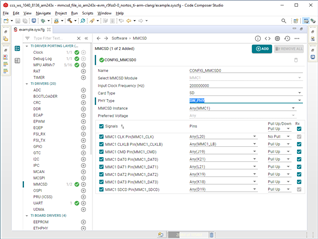

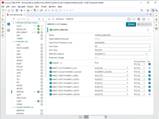

  • Hi Li,
    I was using the mmcsd file I/O example from the AM243x MCU+ SDK 08.01.00.36. Here is the SD card sysconfig:
    Here is the mmcsd file I/O example in AM64x MCU+SDK 08.01.00.36. They look the same:
    So I think the pinmux for SD card on AM243x LP and AM64x EVM is the same. The syscfg generated files (including ti_drivers_config.c and ti_driver_open_close.c) are the same too.
