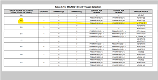

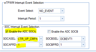

I am trying to configure the ADC to trigger from PWM in a single conversion mode but I am struggling to trigger it.
I have set the SOC A and the flag is set as per my configuration however the ADC conversion is not triggered.
is there an example that I can follow to configure the ADC module to trigger off from PWM module?
I am trying to trigger group 1.

/* Event Trigger Source */
ADC_1->G1SRC = (uint32)(16U);
