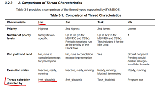

Part of my code is running in an ISR (Hwi Thread) and it calls a function pointer that posts an Event using Event_Post . According to the SYSBIOS User Guide, it is safe to call this API from a Hwi Thread.
Before calling the Event_Post  function I disable all interrupts using Hwi_disable().  According to the User Guide, this should also disable the Thread Scheduler. (See image below)
When running my application, the Event_Post  function called from a Hwi Thread results in a Task_restore call that enables the interrupts, tries to switch the executing Task and following that a failing stack check. (Because of the comparison of wrong stacks)

Is this really the correct behaviour if I call the *_Post function from a Hwi Thread?
I suspect that I am doing something wrong here.

    I think I found the origin of my problem. It seems that my problem was the interrupt priority.
    ARM's NVIC in this case seems really odd. I was specifying an IRQ priority of 2 and did not recognize that this results in a Zero Latency IRQ, which is not dispatched and therefore should no call the SYSBIOS APIs like I did.
    One needs to know how the NVIC priorities are interpreted:
    For most TI MCU devices, 8 priorities are supported. A peculiarity of ARM's NVIC is that, although the priority field is an 8 bit value, the range of supported priority values are left-justified within this 8 bit field. Consequently, the 8 priority values are not 0 thru 7 as one might expect, but rather:
          0x00    // highest priority, non dispatched, Zero Latency priority
          0x20    // highest dispatched interrupt priority
          0x40
          0x60
          0x80
          0xa0
          0xc0
          0xe0    // lowest dispatched interrupt priority, (default)
    The information is available in the API doc of the ARM M3 HWI:
    http://software-dl.ti.com/dsps/dsps_public_sw/sdo_sb/targetcontent/bios/sysbios/6_76_04_02/exports/bios_6_76_04_02/docs/cdoc/ti/sysbios/family/arm/m3/Hwi.html (See INTERRUPT PRIORITIES and Details of config Hwi_disablePriority)
    It would may help people if this Information is available in the TI-RTOS Kernel (SYS/BIOS) User's Guide where the information I cited above is documented.
