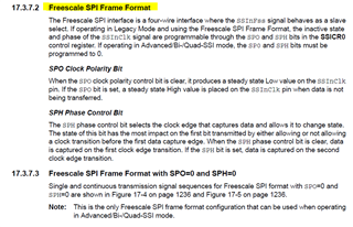

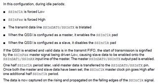

I am using the SSI interface in legacy mode. My understanding is in legacy mode, these can be used as SPI bus interface. Please confirm this. Also, while using as SPI bus, is it recommended to add series resistors to these lines?
Also, where can I find the waveforms for this interface, while using in SPI mode?
