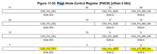

The manual does not specify how to perform page reading for nor flash,are there any detailed steps?What is the command for page read?

Hi Li,
EMIF supports Page mode reads for NOR Flash. The page mode can be enabled by writing a 1 to the CSn_PG_MD_EN (n = 2, 3, or 4) field in the Page Mode Control register
for the chip select in consideration.
Whenever Page Mode for reads is enabled for a particular chip select, the page size for the device connected must also be programmed in the CSn_PG_SIZE field of the Page
Mode Control register. The address change to valid read data available timing must be programmed in the CSn_PG_DEL field of the Page Control register.
The HalCOGen GUI has options to enable the page mode for NOR flash reading:
Note: The Extended Wait mode and the Select Strobe mode must be disabled when using the asynchronous interface in Page mode.
