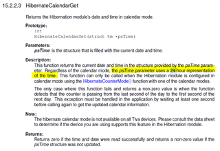

      The DateTimeDisplayGet is a user function written in the example. DateTimeDisplayGet is not a TivaWare API. If you look at the DateTimeDisplayGet code in the calendar example, it will then call DateTimeGet(). DateTimeGet() finally calls the TivaWare API HibernateCalendarGet(). See below. HibernateCalendarGet will return the current time in a 24-hour representation. Therefore, there is no problem with TivaWare API HibernateCalendarGet().
    It is the DateTimeGet() user function that does post processing to produce AM/PM time instead of 24hour time. You are free to modify the example in the format you desire. Again, DateTimeGet() is a user function, not an TivaWare API.
