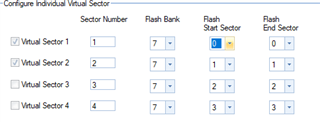

This code above works, and writes  the content to 0xF020_0038 address but As you see in the picture flash bank7 starts from 0xF020_0000.
And it was seperated 4 block in the picture.
2. What is the difference between the blocks in datasheets and the blocks in Halcogen fee driver ?
In fee driver, there specified a header takes part at top of block in size of 16bytes. But the offset in my case is 0x38H so 56 bytes.
3. Where can this offset come from ?
    Please refer to 2.1.2 Data Block Organization in FEE user manual.
    The size of virtual sector header is 32 bytes, and block header is 24 bytes. For the 1st block in the virtual sector, the address offset for data payload is at 32+24=56.
