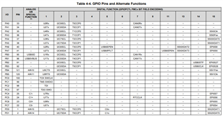

When looking at the multiplexing table ('4-4 GPIO Pins and Alternate Functions' in the datasheet), all the ports special and digital functions are listed:
Although we have not manually set the port A to use digital function 1 in the code (kept it in default GPIO mode), does the call to any of the DriverLib functions (ex. `GPIOPinTypeUART(GPIO_PORTA_BASE, GPIO_PIN_0 | GPIO_PIN_1);`) override the default GPIO mode, and force all of Port A to use digital function 1? In other words, does using some pins on a port for serial communications force the entire port out of default GPIO mode, or can the other pins (i.e. 2 to 7) be used for other GPIO functions (such as toggling LEDs, etc)?
