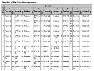

I am trying to set up DMA for the SSI2 Rx. When I included udma.h (comes with Tivaware C Series 2.2.0.295) into my project, I found the following:

The definitions do not match the Tiva microcontroller, but they seem to be for the Stellaris MCUs. Please confirm this and advice if I can continue to use these modules (udma.h and udma.c).

  • Hello Tianlei,
    Couple elements to this... first I'll explain the table, and I can address your specific issue which is caused because the table seems to be missing entries (Which I don't know how that wasn't filed as a bug report before...?!?)
    This will match for TM4C MCUs and there is a reason that they have been provided this way. To start, here is the table out of the datasheet:
    What you'll see is that the names used map tot he Encoding 0 Peripherals. For the 'Reserved' channels, it appears that either internal names were released as part of the package or maybe you guess there was a Stellaris device which that matched for - either way, I was not part of the team so I can't really comment on why we chose to do that, but that is why they don't seem to match at a glance. But you'll see that UART, ADC, Timer etc. all match up properly to the channel #.
    Now the reason we have the single define and not one for SSI2 which is Encoding 2 on Channels 12 & 13 is that a uDMA channel cannot be assigned to multiple peripherals at once. If we made unique names for every iteration of the channel # and peripheral association, then a user would just use it without understanding how the channel is actually shared with other peripherals. Having the single name for a channel requires them to review the datasheet and find the proper channel as well as understand that if their peripherals share the same channel, they will need to either only select one peripheral or re-configure the uDMA each time that peripheral needs to use the uDMA.
    Now with that explanation given...
    You need uDMA channels 12 & 13 for SSI2. Unfortunately for reasons I don't really understand, those channels don't even have defines. So for this case I would recommend you make your own such as:
    #define UDMA_CHANNEL_CH12     12
    #define UDMA_CHANNEL_CH13     13
    In all honesty, the nomenclature I used above is what should have probably been done day 1 but I didn't have any role in the initial update. I've submitted a bug ticket in the meantime so when we do the next update we will address that and probably revisit the unclear table as well (which probably will require having a legacy + modern table so it is backward compatible.)
    Ralph Jacobi
