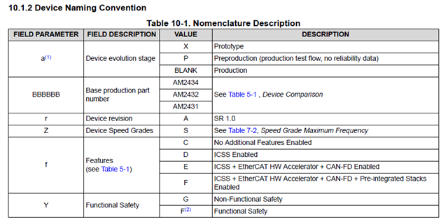

     I want to make sure whether our AM2431 chip supports the full protocol stack(F)?

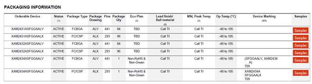

     As below I see the info about the datasheet, But l learn from BU side, we only support the full protocol stack above AM2432
    Or other words, I recommend the XAM2431AKFGGAALX to customer, so it support full protocol stack.
    Because I see the detail info as below:
  • Hi Shaoxing,
    AM2431 does not support protocol stacks. Only AM2432 and AM2434 devices will support protocol stack option.  The XAM2431 is just a superset pre-production part number with stacks enabled, but won’t go to mass production.
