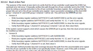

    32.3.2 Checking for eFuse Errors After Power Up
    For safety critical systems, it is required that you check the status of the eFuse controller after a device
    reset. A suggested flow chart for checking the eFuse controller after device reset is shown in Figure 32-1.
    Failures during the eFuse self test can be grouped into three levels of severity. Depending on the safety
    critical application, the error handling for each error type may be different.
    32.3.2.1 Class 1 Error
    A class 1 error of the eFuse controller means that there was a failure during the autoload sequence. The
    values read from the eFuses cannot be relied on. All device operation is suspect. A class 1 error is
    indicated by a signal to group 3 channel 1 of the ESM. This will cause the ERROR pin to go active low.
    32.3.2.2 Class 2 Errors
    A class 2 error is an indication that the safety checks of the eFuse controller did not work. These are also
    serious errors because you can no longer guarantee that a more severe error did not occur.
    32.3.2.3 Class 3 Error
    A class 3 error indicates that there was a single bit failure reading the eFuses that was corrected by ECC
    bits. Proper operation is still likely, but the system is now at a higher risk for a future non-correctable error.
    When a correctable error occurs, ESM group 1, channel 40 will be set. In the suggested flow chart shown
    in Figure 32-1 below, the single bit error is determined by directly reading the eFuse error status register,
    and not depending on the integrity of the connections between the eFuse controller and the ESM.

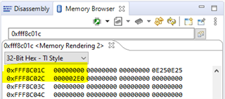

    This has been observed on 5-6 boards. Bits 17, 16, 15 and 14 are also set.

    Before starting the stuck-at-zero test, there is a step in the flowchart which says that I should check for ESM Group 3 Channel 1 error. I am using bit 10 (EFC Autoload error) of the EFC Pins Register for this check, because as per TRM, this bit also sets ESM group 3, channel 1. And this check is showing that ESM Group 3 Channel 1 error is set after reset. So should I manually clear all the bits in EFCBOUND register, and then follow the eFuse self test flow chart?

    Therefore, you see the nERROR pin goes low right after reset? Please confirm. Can you show EFCPINS register right after reset?  Perhaps also show EFCBOUND register. I want to know if you are getting an autoload failure right after power up.

      I suspect that you use HalcoGen as a reference to build your project. In HalCoGen the Efuse Selftest is enabled. This is why your bit 17-14 are already set before you start the stuck-at-zero test. Please confirm if this is the case.
    If you have not run any Selftest earlier, the EFCBOUND and EFCPINS registers should look like below after power up where you can see the EFCBOUND register is all zeros and the care-about bits in EFCPINS are also zeros.
    As I mention, you can clear EFCBOUND register manually before launching your stuck-at-zero test had you already run Efuse Seltest earlier from HalCoGen startup.
