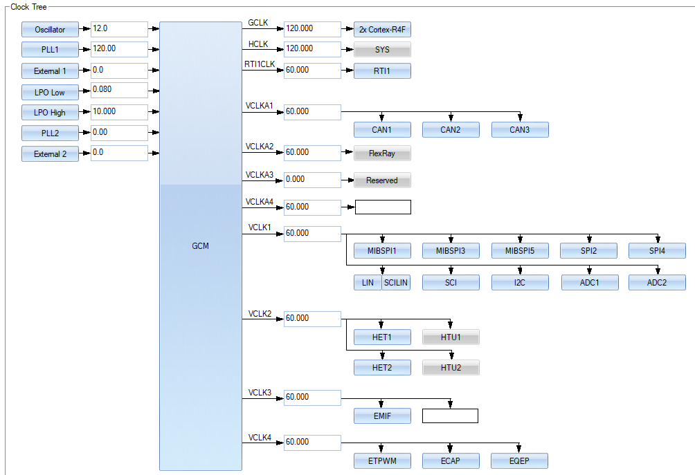

With Halcogen we generated a initial Project. We tried to set the core Frequency to 120Mhz(and also 160MHz and 180MHz). However, we are using this 120MHz in our old project. Our configurations are below.

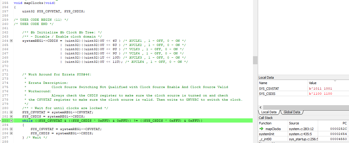

When we run our genereated code. It stack at the point when the programm waits until the clocks are locked.
Do you have an idea how we can check that the hardware is designed correctly? are there some points which should be measured?
Or how can we verify that there are no missing configuration settings in halcogen?
Here are my configurations:

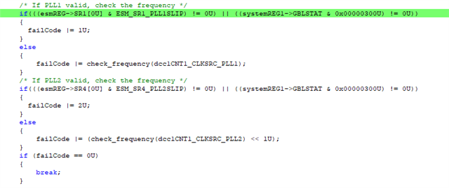

    In _errata_SSWF021_45_both_plls both PLLs fail:
    The values of the register are:
    esmReg->SR1[0]  = 0x400,
    esmReg->SR4[0]  = 0x0; and
    systemREG->GBLSTAT = 0x300

    However, we can not see a signal on ECLK if we use PLL1 as output. Probability because the bit for PLL1 in the register CVSTAT was 0.
    After trying to run PLL1 correctly, we tried to run the workaround after PLL has been setup..- Unfortunately, we have the same Issue here:
