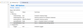

    For a task created by Task_create() to have a label shown in ROV requires that:
    a. The SYS/BIOS configuration .cfg file has the following to set the namedInstance parameter to true:
    var Task = xdc.useModule('ti.sysbios.knl.Task');
    Task.common$.namedInstance = true;
    b. The taskParams.instance->name passed to Task_create() has the string for label set.

  • Thanks, that does the trick!
    My TI RTOS release.cfg already contained, (near the end):
    var ndkHooks = new Task.HookSet();
    ndkHooks.registerFxn = '&NDK_hookInit';
    Task.addHookSet(ndkHooks);
    So All I had to do was add:
    After building that, the ROV task view now shows labels "DHCPclient" and "ndkStackThread", as these are created with generated code that uses the native TI RTOS calls rather than the Posix wrapper.

  • I looked before (badly), and failed to spot that Task.common$.namedInstance = true; can also be set in the TI RTOS project GUI editor:
