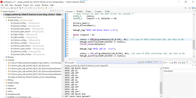

Hi Experts,
     I am using Sysconfig to configure GPIO, and then implement LED_BLINK, you can see the  code is well executed.
here is my project, I Exporting to Archive follow the
https://software-dl.ti.com/ccs/esd/documents/ccs_sharing-projects.html
maybe you can import to check what's problem with the project, and No lights on the board are flashing when I run the project.
LED_BLINK.zip
  • Hi Shaoxing,
    The gpio_led_blink_am243x-lp_r5fss0-0_nortos_ti-arm-clang does work OK on AM243x LP. It turns on/off LD1 (a green LED next to the RGMII2). It is hard to see, because it is behind the RJ45 connectors.
