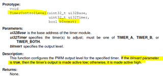

The customer would like to know how to use the timer or pwm module to output low. They have set the duty cycle to 0 and the output is high.
Could you help check this case? Thanks.

Hi Cherry,
Please see below API to invert the output.
