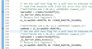

  • Hi Wang,
    The SL_SelfTest_SRAM - SRAM_ECC_ERROR_FORCING_2BIT failed continuously. Any configuration is required to perform this test?
    Monish P
  • Hi Monish,
    Some diagnostics test, for example SRAM_ECC_ERROR_FORCING_2BIT test, result in data aborts. Does your project have data abort handler? The Data abort handler is not part of the safety diagnostic library.
    When you step through the code, did you get ESM flag set (ESM 3.3 and ESM 3.5) when reading the SRAM content whose ECC bits are flipped intentionally?
  • Hi Wang,
    Whether SW can detect the ESM group 3 errors using ESM_ApplicationCallback function?
  • Hi Monish,
    1. The callback function is:
    void ESM_ApplicationCallback(uint32 grp_channel, uint32 param1, uint32 param2, uint32 param3) in esm_application_callback.c
    This callback function are for esm group 1/2/3.
    2. you can add breakpoints at line 278 and line 284 in sl_selftest.c to see if the ESM flag is set by reading the memory content whose ECC bits have been flipped:
    The ESM flag is cleared at the end of this function after the selftest is finished.
