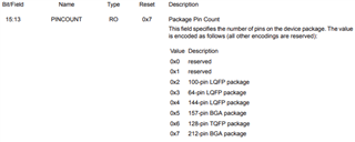

1. Determine at time-zero prior to any configuration whether it is a TQFP or BGA version and branch to different code to configure based on this?
2. I know that which CPU you are using is a defined pre-processor constant and decisions are made within the libraries based on what to do at compile-time.  Is this going to prevent our attempt from working?
3. What other questions should I be asking?
  • 1. Determine at time-zero prior to any configuration whether it is a TQFP or BGA version and branch to different code to configure based on this?
    From a quick look at the datasheet, the Device Identification 1 (DID1) register contains a PINCOUNT field which should allow the package to be determined at run-time:

    If necessary, there are Peripheral Present registers in the System Control module which could at run-time be used to handle differences in the set of available peripherals in the device.
