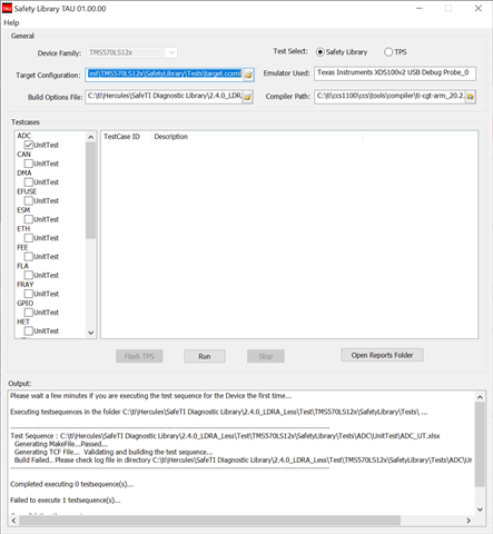

TMS570LS1224: SDL-CSP-LS12-NOLDRA cannot run unit tests using SafetyLibraryTAU
Part Number: TMS570LS1224
I have obtained an LDRA eval license in order to execute the SafeTI Lib unit tests using SafetyLibraryTAU. Unfortunately the build fails. I have attached the log.
  • I am on Windows 10
  • I have tried StrawberryPerl, both 32 and 64 bit versions
  • I use LDRAunit-TI-Qual_C_CPP_9.4.3
  • I use CCS11 (has a 20.x LTS compiler)
What I gather from the log:
  • Some Perl variables are undefined
  • The set for LDRA appears empty
I did not find anything in the manual that would have enabled me to solve this issue.
I also tried to use LDRA directly but I got stuck there, too.
LDRA Install Dir:C:\Program Files (x86)\LDRA\LDRAunit-TI-Qual_C_CPP_9.4.3\

Generating Make file for C:\ti\Hercules\SafeTI Diagnostic Library\2.4.0_LDRA_Less\Test\TMS570LS12x\SafetyLibrary\Tests\CAN\UnitTest\CAN4A_UT.xlsx ...  MakeFile Generation Passed
Generating TCF file for C:\ti\Hercules\SafeTI Diagnostic Library\2.4.0_LDRA_Less\Test\TMS570LS12x\SafetyLibrary\Tests\CAN\UnitTest\CAN4A_UT.xlsx...Name "main::Procedure" used only once: possible typo at C:\ti\Hercules\SafeTI Diagnostic Library\2.4.0_LDRA_Less\Test\Misc\Scripts\Generate_TCF.pl line 881.
Use of uninitialized value $TCF_Description in scalar chomp at C:\ti\Hercules\SafeTI Diagnostic Library\2.4.0_LDRA_Less\Test\Misc\Scripts\Generate_TCF.pl line 597.
readline() on closed filehandle SYSEARCH at C:\ti\Hercules\SafeTI Diagnostic Library\2.4.0_LDRA_Less\Test\Misc\Scripts\Generate_TCF.pl line 1929.
readline() on closed filehandle SYSPPVAR at C:\ti\Hercules\SafeTI Diagnostic Library\2.4.0_LDRA_Less\Test\Misc\Scripts\Generate_TCF.pl line 1911.
Use of uninitialized value $TCF_Description in concatenation (.) or string at C:\ti\Hercules\SafeTI Diagnostic Library\2.4.0_LDRA_Less\Test\Misc\Scripts\Generate_TCF.pl line 718.
3Qt: Untested Windows version 6.2 detected!
Initialising License started
Initialising License finished
Unable to retrieve generic license information
...Logging on
Command line specifies invalid file(s) for addition to the set:
Loading set TMS570LS12x_SafeTI_Library started
Loading set TMS570LS12x_SafeTI_Library finished
Command line:
 "C:\Program Files (x86)\LDRA\LDRAunit-TI-Qual_C_CPP_9.4.3\Conunit-ti-qual.exe" TMS570LS12x_SafeTI_Library /create_set=system /add_set_file=""C:\ti\Hercules\SafeTI Diagnostic Library\2.4.0_LDRA_Less\safety_library\source\sl_selftest.c"" /add_set_file=""C:\ti\Hercules\SafeTI Diagnostic Library\2.4.0_LDRA_Less\safety_library\source\sl_init.c"" /add_set_file=""C:\ti\Hercules\SafeTI Diagnostic Library\2.4.0_LDRA_Less\safety_library\source\sl_esm.c"" /add_set_file=""C:\ti\Hercules\SafeTI Diagnostic Library\2.4.0_LDRA_Less\safety_library\source\sl_log.c"" /add_set_file=""C:\ti\Hercules\SafeTI Diagnostic Library\2.4.0_LDRA_Less\safety_library\source\sl_priv.c"" /add_set_file=""C:\ti\Hercules\SafeTI Diagnostic Library\2.4.0_LDRA_Less\safety_library\source\sl_misc.c"" /1q
Command Line Mode started
TCF Generation Passed
Executing Testcase for C:\ti\Hercules\SafeTI Diagnostic Library\2.4.0_LDRA_Less\Test\TMS570LS12x\SafetyLibrary\Tests\CAN\UnitTest\CAN4A_UT.tcf
Use of uninitialized value $Reports_Dir in pattern match (m//) at C:\ti\Hercules\SafeTI Diagnostic Library\2.4.0_LDRA_Less\Test\Misc\Scripts\Unit_Test_LDRA.pl line 165.
Use of uninitialized value $Reports_Dir in -d at C:\ti\Hercules\SafeTI Diagnostic Library\2.4.0_LDRA_Less\Test\Misc\Scripts\Unit_Test_LDRA.pl line 170.
Use of uninitialized value $Reports_Dir in mkdir at C:\ti\Hercules\SafeTI Diagnostic Library\2.4.0_LDRA_Less\Test\Misc\Scripts\Unit_Test_LDRA.pl line 174.
C:\PROGRA~2\LDRA\LDRAunit-TI-Qual_C_CPP_9.4.3\LDRAconunit-ti-qual.exe TMS570LS12x_SafeTI_Library -tcf_mode=overwrite /21q -tcf=C:\ti\Hercules\SafeTI Diagnostic Library\2.4.0_LDRA_Less\Test\TMS570LS12x\SafetyLibrary\Tests\CAN\UnitTest\CAN4A_UT.tcf -regress -quitQt: Untested Windows version 6.2 detected!
                   Welcome to TBrun(TM)
  The LDRA Testbed Test Harness Generator Version 9.4.3
    Copyright Liverpool Data Research Associates Ltd.
Set TMS570LS12x_SafeTI_Library contains no files.
TBrun can only be run on sets that include source files.
 Type return to continue
Specified tcf not found.
Unable to create sequence from TCF file
Unit Test Completed for C:\ti\Hercules\SafeTI Diagnostic Library\2.4.0_LDRA_Less\Test\TMS570LS12x\SafetyLibrary\Tests\CAN\UnitTest\CAN4A_UT.tcf

  • The eval license doesn't include the license for TBRUN which is required for the test.
  • I´ll ask LDRA for TBurn. Before TBurn, this is also failing:
    Unable to check out license for LDRAunit
    Reason: No such feature exists.
    Feature: Win_C/C++_LDRAunit_TI
     I have contacted LDRA and they are of the opinion that this is due to Windows 10 incompatibility. But to me it seems like just the names of the license portions and the one that TAU requests do not match up. These are the names in the license file:
    PACKAGE Win_C/C++_Unit-TI-Qual LDRA 9.43 \
        COMPONENTS="Win_C/C++_LDRAunit-TI-Qual_ti:9.43 \
        Win_C/C++_TBCALL_ti:9.43 Win_C/C++_TBFLOW_ti:9.43 \
        Win_C/C++_TBGLHAPI_ti:9.43 Win_C/C++_DYNAMIC_ti:9.43 \
        Win_C/C++_TBSAFE_ti:9.43 Win_C/C++_TBunit-TI-Qual_ti:9.43 \
        Win_C/C++_TBGLHSUPPORT_ti:9.43 Win_C/C++_TBGLHCOMPARE_ti:9.43 \
    FEATURE Win_C/C++_Unit-TI-Qual LDRA 9.43 02-feb-2022 1 \
    TAU requests:
    Feature: Win_C/C++_TBunit-TI-Qual_ti
    TBurn is missing, but the other one seems to be requested by a different name?
  • I made some progress. The license issue was caused by some fs permissions issues. The license error is gone now. Error is now:
    I had just started TAU (as admin) from the LDRA less folder and selected ADC to run.
    This is the full log:

    Generating Make file for C:\ti\Hercules\SafeTI Diagnostic Library\2.4.0_LDRA_Less\Test\TMS570LS12x\SafetyLibrary\Tests\ADC\UnitTest\ADC_UT.xlsx ...  MakeFile Generation Passed
    Generating TCF file for C:\ti\Hercules\SafeTI Diagnostic Library\2.4.0_LDRA_Less\Test\TMS570LS12x\SafetyLibrary\Tests\ADC\UnitTest\ADC_UT.xlsx...Name "main::Procedure" used only once: possible typo at C:\ti\Hercules\SafeTI Diagnostic Library\2.4.0_LDRA_Less\Test\Misc\Scripts\Generate_TCF.pl line 881.
    4Qt: Untested Windows version 6.2 detected!
    Connection timeout 20 seconds
    Normal hostid 1
    Minimum user inactivity timeout (seconds): 900
    Total licenses in use: 1
    Total number of licenses: 1
    ...Logging on
    Command line:
     "C:\Program Files (x86)\LDRA\LDRAunit-TI-Qual_C_CPP_9.4.3\Conunit-ti-qual.exe" TMS570LS12x_SafeTI_Library /create_set=system /add_set_file=""C:\ti\Hercules\SafeTI Diagnostic Library\2.4.0_LDRA_Less\safety_library\source\sl_selftest.c"" /add_set_file=""C:\ti\Hercules\SafeTI Diagnostic Library\2.4.0_LDRA_Less\safety_library\source\sl_priv.c"" /add_set_file=""C:\ti\Hercules\SafeTI Diagnostic Library\2.4.0_LDRA_Less\safety_library\source\sl_init.c"" /add_set_file=""C:\ti\Hercules\SafeTI Diagnostic Library\2.4.0_LDRA_Less\safety_library\source\sl_esm.c"" /add_set_file=""C:\ti\Hercules\SafeTI Diagnostic Library\2.4.0_LDRA_Less\safety_library\source\sl_log.c"" /add_set_file=""C:\ti\Hercules\SafeTI Diagnostic Library\2.4.0_LDRA_Less\safety_library\source\sl_misc.c"" /1q
    Executing Testcase for C:\ti\Hercules\SafeTI Diagnostic Library\2.4.0_LDRA_Less\Test\TMS570LS12x\SafetyLibrary\Tests\ADC\UnitTest\ADC_UT.tcf
    C:\PROGRA~2\LDRA\LDRAunit-TI-Qual_C_CPP_9.4.3\LDRAconunit-ti-qual.exe TMS570LS12x_SafeTI_Library -tcf_mode=overwrite /21q -tcf=C:\ti\Hercules\SafeTI Diagnostic Library\2.4.0_LDRA_Less\Test\TMS570LS12x\SafetyLibrary\Tests\ADC\UnitTest\ADC_UT.tcf -regress -quitQt: Untested Windows version 6.2 detected!
    Normal hostid 1
    Unit Test Completed for C:\ti\Hercules\SafeTI Diagnostic Library\2.4.0_LDRA_Less\Test\TMS570LS12x\SafetyLibrary\Tests\ADC\UnitTest\ADC_UT.tcf
