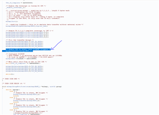

In the example code, how the MIBSPI transfer trigger the tick count trigger. Please clear the following doubts.

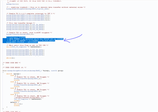

How the FFFF correponds to 65.535 ms ?

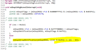

How it enters the mibspiGroupNotification function ?
EXAMPLE CODE:

    /* Enable TG0 to start, once tickCNT triggers */
    mibspiTransfer(mibspiREG1,0);
    /* Configure TICKCNT
     * DATA FORMAT 0 is selected which has SPICLK set as 1000KHz
     * So tick is 0xFFFF * (1/1000KHz) = 65.5535 msec*/
    mibspiREG1->TICKCNT = 0x8000FFFF;

/* USER CODE BEGIN (4) */
void mibspiGroupNotification(mibspiBASE_t *mibspi, uint32 group)
    switch (group){

  • how the MIBSPI transfer trigger the tick count trigger.
    The tick counter can be used as a trigger for TGs. The first time when you enable the tick counter by setting the TICKENA bit the counter is first preloaded with the value from the TICKVALUE register. It will start to down count until the counter underflow (the counter value becomes zero). Every time the tick counter detects an underflow it reloads the initial value and toggles the trigger signal provided to the TGs. Once a TG is triggered, the buffers belonging to it will be transmitted.
    You are correct. It is 0xFFFF*period of SPI clock. If the SPI clock is 1MHz, the trigger internal is 65535us = 65.535ms.
    mibspiGroupNotification() is a callback function provided by the application. It is call when a transfer is complete.
