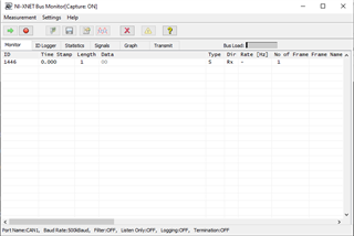

    When PacketWrite(node, CAN_COMMAND_ACK, &ucStatus, 1) is called, do you see the transmitted data on CAN bus?
  • I didn't change the baudrate in the can.c or can.h files, so It should be set to 500k still.  I inserted the PacketWrite command just before the switch and monitored the bus.  This is the result.
  • I can now see that the ID of 1446(Dec) is the correct 0x05A6 ACK.  Is the fact that the Micro receives the 0x05A0 Ping and responds confirms that the USB-8502 is sending and receiving at the correct BAUD rate, correct?

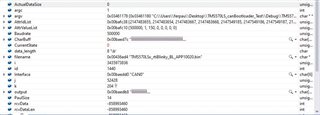

  • Using break points in both the MCU code I can give the following additional feedback.  With the MCU code running I see the ping come in, I see it parsed by the MCU, and I see it respond on the Can Bus.  The following is the message sent back when monitering that bus.
    The PC side code current state changes to 3
    The RecieveBuff, however, doesn't change.
    and the size error is thrown.
    With the CAN cable disconnected, the Current State stays 0 and the Ping times out.
    Why can I see the message on the CAN bus monitor at 500k but the PC Side code cannot seem to read it?

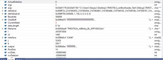

  • I was successful in establishing 2 way communications with the PC side code.  The NcRead call was the problem. I changed all the ACK read requests to use the following NcReadMult instead.
    Status = ncReadMult(RxHandle, sizeof(ReceiveBuf), (void*)ReceiveBuf, &ActualDataSize);

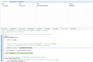

    With communications established, I was able to download our binary file (compiled to start at address 0x00010020) and transmit it to our MCU.  The update check, however fails with the UpdateStatusAddr showing the following value.
    Does our image need to set the 0x5A5A5A5A value, or does the bootloader do that?
  • The bootloader writes the flag to 0x10000 after the binary image has been programmed successfully.

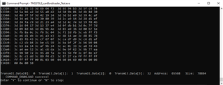

  • Adding a bunch of debug statements, I can now see what is failing.  While the comands are being transmitted properly, it appears the data is not.  The external code is receiving ACK from the MCU and going about its tramsmit and signalling success.  The MCU is failing the address and size though and not accepting or writing any data.  This is the external code sending the address.
    The address (in DEC form) and size are correct, as well as the breakdown.  This is what is received by the MCU
    The g_pucCommandBuffer[] elements are all 32, leading to an incorrect conversion and incorrect address and size.  This results in the g_ulTransferSize being set to 0 and nothing being written.

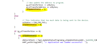

  • In troubleshooting the size I have determined that the routine to read the CAN DataA and B registers was not working correctly.
    pusData = (uint8_t*)pucData;
    /** - Copy RX data into destination buffer */
    for (i = 0U; i < ulBytes; i++)
    #if ((__little_endian__ == 1) || (__LITTLE_ENDIAN__ == 1))
    *pusData++ = node->IF1DATx[i];
    #else
    *pusData++ = node->IF1DATx[g_ulCanByteOrder[i]];
    #endif
    GADataBuffer[0] = node->IF1DATx[3U];
    GADataBuffer[1] = node->IF1DATx[2U];
    GADataBuffer[2] = node->IF1DATx[1U];
    GADataBuffer[3] = node->IF1DATx[0U];
    GADataBuffer[4] = node->IF1DATx[7U];
    GADataBuffer[5] = node->IF1DATx[6U];
    GADataBuffer[6] = node->IF1DATx[5U];
    GADataBuffer[7] = node->IF1DATx[4U];
    the pusData was never getting the actual data in the register and therefor the g_ulTransferSize and g_ulTransferAddress were filling with all '32's.  I  was able to parse the data with my own buffer correctly and feed that into the Address and Size.
    The code then errored with the size check as the ulWholeFlashSize was coming out at 0.  I eliminated the size address check and now I am geting an access violation.
