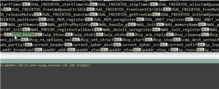

  • Ming,
    thanks for the reply.
    Rebuilding the lwIP is not the issue. The issue is, that the library, C:\ti\mcu_plus_sdk_am243x_08_01_00_36\source\industrial_comms\profinet_device\stack\profinetiodevice_rgmii.am243x.r5f.ti-arm-clang.release.lib is not updated after rebuilding the lwIP.
    We estimate, that the lwIP is precompiled and linked into profinetiodevice_rgmii.am243x.r5f.ti-arm-clang.release.lib (see lwip symbols in hex editor, attachment).
    To be able to rebuild the lwIP for our needs, we need access to the sources, so that we can build the profinetiodevice_rgmii.am243x.r5f.ti-arm-clang.release.lib (same issue for Ethernet/IP). Is that possible?
    Tommy
  • Hi Tommy,
    We do not provide the source code of the common stack.
    Currently, the LWIP library used by the profinetiodevice_rgmii.am243x.r5f.ti-arm-clang.release.lib is an precompiled older LWIP library, not the one included in the MCU+ SDK. In the future (4Q 22) you can use/rebuild the LWIP in MCU+ SDK for Profinet stack only.
    Ming
