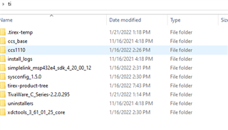

    Below is the installation directory of the ti tools.
    Could you please provide me the download link of the appropriate TI-RTOS and XDCtools  and if any necessary steps I need to follow to make the build through?
    Thanks.
    Snehashis

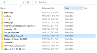

  • Hello Charles,
    Thank You for the links.
    I have installed the proper RTOS.
    But getting the same issue.
    I believe I am missing something.
    Could you please let me know if I need to follow any specific procedure?
    Thanks.
    Snehashis

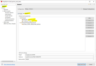

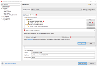

  • Hi Snehashis,
      In CCS, go to the below page and show what you have. You need to change to the correct version for XDCtools and TI-RTOS for TivaC. In the screenshot below, I have shown the steps for XDCtools. Same steps to edit the version for TI-RTOS.
      In CCS, right-click on the CCS project and select Properties and you will see the below page.
      1. Go to General
      2. Select Products
      3. Select XDCtools (Once you are done with XDCtools, you will select TI-RTOS for Tiva and go through the steps again to edit the correct version).
      4. Select Edit
      5. The menu allows you to select the version you need if the required version is installed. If the version you need does not show up, you may in CCS, go to File and select "Refresh". Or try to first exit CCS and then launch CCS again.
