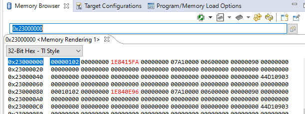

  • Hi Ming,
    could you elaborate on how peripheral registers are best viewed in CCS Memory Browser. I hope there is something better than
    (for EPWM0 as an example).
    Johannes
  • Hi Johannes,
    In order to see the bit map of the registers for each peripheral, there should be the corresponding XML files in the ccs_base\common\targetdb\Modules\am243x folder. Also the ccs_base\common\targetdb\devices\AM2434_ALV.xml has to refer to them. In CCS 11.1.0. the reference and the folder are not there. That is why you cannot see them in the register view. I will file a bug against this. Meanwhile the best way to view the peripheral registers is using the memory browser and refer to the TRM for bitmap definition.
