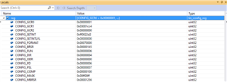

I read out the LIN config with the halcogen function "linGetConfigValue(&reg, CurrentValue)" see following screenshot of the LIN config registers.
Register GCR1 says: LIN mode enabled (bit 6) and LIN slave mode (bit 5)
Register FUN/PIO0 says: LINRX is the receive pin (bit 1), LINTX is the transmit pin (bit 2)
Registers seems to be configured correctly for me.

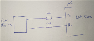

  • If we connect the LIN Tx and Rx to a LIN Transceiver, and have a LOW signal on the 12V bus wire, we get a LOW signal on the Rx pin of 2.0V. The HIGH signal is fine on 3.3V.
    The RX low level should be < VIL. How do you wire the MCU and LIN transceiver? The LIN node acts as open-drain, so the LIN bus requires a pullup resistor. The pullup resistor values are different for the master and slave nodes. The master node requires an external pullup resistor and diode. The typical value seen is 1 kohms in series with a diode connected to the battery voltage. The typical pullup value of the LIN slave is 30 kΩ, and in all modern LIN transceivers, this is integrated within the IC, so no external pullup is necessary in the slave configuration.

    This is our connection between the MCU and LIN transceiver:
    We use the Infineon TLE8457DSJ in slave configuration. This IC has the mentioned slave-pullup integrated.

  • If you drive the MCU LIN TX to logic LOW, the transceiver generates a dominant level on the LIN BUS, the MCU should read back the signal on the LIN RX as LOW. if you drive the MCU TX pin to HIGH, the transceiver sets the LIN BUS to the recessive level, and  MCU LIN TX is pulled to HIGH.
