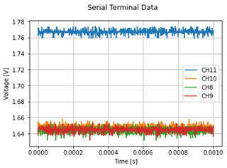

I am using the EK-TM4C1294XL to measure 4 analog channels (CH11, CH10, CH8, CH9). I am using sequence 0 to collect the data using 4 steps. CH11 is collected on step 0, CH10 on step 1, CH8 on step 2, CH9 on step 3. Each ADC pin is connected to 1.65V though a voltage divider of two 10K resistors connected between the launch pad's 3.3V and GND.
Bellow is a plot of the data that is collected. I am expecting each channel to read ~1.65V but there is a large ~0.2V offset on CH11 collected on step 0.
If I switch which channels are collected on the steps , ex collect CH10 on step 0 and CH11 on step 1, the offset follows the sequence step and not the analog channel. I have not been able to figure out why this offset is occurring. Have I missed some setup or configuration?

    That is a pretty large input impendence to the ADC. The ADC source resistance is just 250 ohm. I think with the amount of input impendence, what's happening is that with the first sample the input has not fully settled on the internal capacitors when the first measurement is being taken while the latter samples have added time passing that lets the signal settle and therefore get an accurate reading - this lines up with how if you change which channel is first, the offset is just following that first reading.
    Can you repeat the experiment but with lower resistors like 3.3kOhm or even down to 1kOhm resistors for the divider instead?
    I really don't think this is a configuration issue as much as needed to let the signal settle in time for the ADC so let me know if that resolves the issue or not.

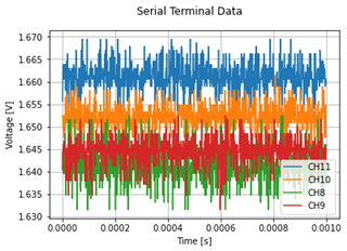

  • Hi Ralph,
    That has seemed to fix the issue. The reading are closer to what I would expect.
