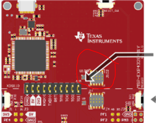

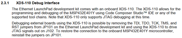

1) Most cost effective ~$39 U.S. - All of our MSP432 Launchpads development kits have an xds110 compatible programmer/debugger built on board. Here is the link to the MSP432E401 user guide. The second paragraph describes how to program an external MSP432 (your target).
The launchpad does come with a small cable than connects to J102, but I don't know what you are using on your target board to allow connections to your MSP432's JTAG connections. You might have to modify the cable.
