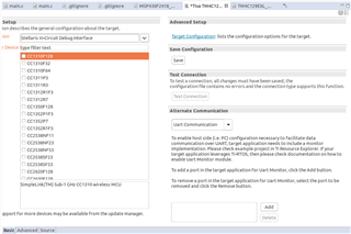

    In the CCS Target Configuration .ccxml for the project, under the Basic tab can you check if the Alternative Communication has a Com Port shown. If a Com Port is listed for the Alternative Communication use Delete so the UART selection is empty:
    With CCS under Linux, I found that if you select to Add an Alternative Communication then adds COM14 by default, which isn't the name of a valid UART port under Linux, which then leads to a "ComPort: Can't Initialize Target CPU: Failed to open COM14 at 9600 baud: open: No such file or directory" error attempting to start a debug session.
  • I was able to get rid of the UART port, but now it doesn't seem to do anything when I hit Debug.  The CORTEX_M4_0 doesn't seem to go anywhere.  Is it necessary to externally mount the Stellaris on board debugger? (I'm still attempting Ralph's suggestion above).  How do I tell CCS where to find the eval board?
    After reading your post, I realized I had no idea what the .ccxml file contained so I created a new one.  When I choose TM4C1294NCPDT in the list of devices it seems like there should be another submenu to choose.  I have the device selected, but the test connection button does exactly nothing from all outward appearances.
