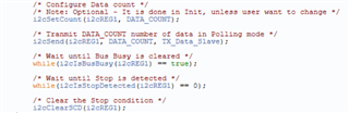

Hi, I have question about I2C Code.
I was looking the example and I've tried to write my own code.
i2cSetSlaveAdd(i2cREG1, Slave_Address); /*Configure address of Slave to talk to*/
i2cSetDirection(i2cREG1, I2C_TRANSMITTER); /*Set direction to Transmitter*/
i2cSetCount(i2cREG1, 1); /*Configure Data count*/
i2cSetMode(i2cREG1, I2C_MASTER); /*Set mode as Master*/
i2cSetStop(i2cREG1); /*Set Stop after programmed Count*/
i2cSetStart(i2cREG1); /*Transmit Start Condition*/
i2cSendByte(i2cREG1, 0x00);
while(i2cIsBusBusy(i2cREG1) == true); /*wait until Bus Busy is cleared*/
while(i2cIsStopDetected(i2cREG1) == 0); /*wait until Stop is detected*/
i2cClearSCD(i2cREG1);
i2cSetDirection(i2cREG1, I2C_RECEIVER); /*Set direction to receiver*/
When i started my application, it waited on 'while(i2cIsStopDetected(i2cREG1) == 0);' code.
I followed HALCoGen's example.
What shall i fix for?
Anthony
  • Hi Anthony,
    Don't you send STP after sending a byte of data?
  • what is STP?
    when i fixed code like below, it worked.
    but still i don't know the reason it works

  • Good to know you have make your code works.
    STP is STOP
    Sending one byte of data will not generate STOP automatically.
    while((i2cREG1->STR & I2C_ARDY) == false); --> You can check BB here instead.
  • On HALCoGen Help(example_i2cSlave_TX_RX.c), don't send STP.
    Then, If i wanna make my code to example, should i use i2cSend instead of iwcSendByte?
  • The STOP condition is automatically generated when the counter reaches zero.
