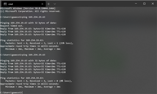

My PC has a static ip of 169.254.19.62, and the EK-TM4C1294XL has a static ip of 169.254.19.63. After programming the EK-TM4C1294XL I can send ping requests to the launchpad and can see packets being sent back to the PC.

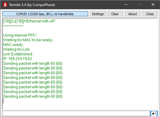

Below is debug output from the launchpad. Packets are being sent in response to a ping request.

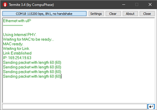

Below is the PC sending packets to the launchpad,

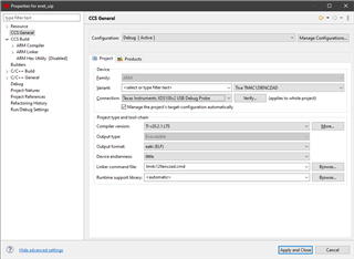

I attempt the change the example enet_uip project to work with the custom PCB that has a TM4C129ENCZADT3 MCU.
I first go to the project properties and change the Device and Connection:
After clicking apply and close CCS seems to add a new linker command file, and startup source file.
I modified tm4c129enczad_startup_ccs.c so that it matches startup_ccs.c and modified tm4c129enczad.cmd so that it matches enet_uip_ccs.cmd. After changing these files, the old files from the example project are removed.

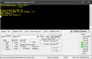

After programming the custom pcb I can not get a link to be established. The program sits at Waiting for Link.
I am not sure if this is a software or hardware problem. I have tried multiple ethernet switches and CAT5e cables with no success. Schematics and gerber files are attached for the custom PCB. Does anyone have any suggestions?

    The enet_lwip example is working on the launchpad. The LP is able to obtain a link and get an ip address,

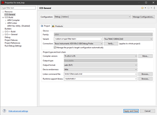

    Going through the same procedure to test the enet_lwip example on the custom board. I first change the device to TM4C129ENCZAD and modify the debugger connection,
    Copying startup_ccs.c to tm4c129enczad_startup_ccs.c and enet_lwip_ccs.cmd to tm4c129enczad.cmd. Then deleting startup_ccs.c and enet_lwip_ccs.cmd.

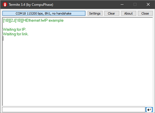

    The custom board with the enet_lwip example also gets stuck at waiting for link.

    Do you think there might be a problem with the differential trace impedance?
    Allan
    enet_lwip_example.zip
  • Hi Charles,
    It turns out that the board house swapped R44 and C7. Unswapping these components fixed the issue!
    I can get a link and ping the custom board!
    Thanks for your help.
    Allan
