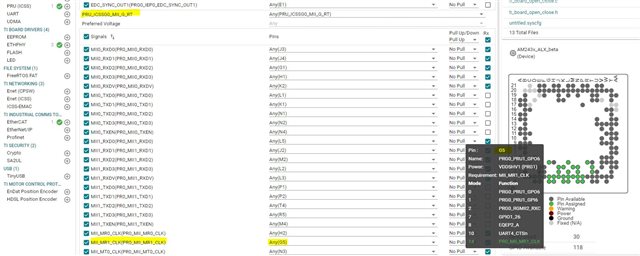

There is different pin name in sysconfig tools than datasheet.
In sysconfig tool, the pin name of PR0_MII_MR1_CLK is 'G5' as below, but 'G5' pin name is as 'VDDR_CORE' in the datasheet.
Could you please let me know what is right?
In sysconfig tool,
in Datasheet,
Thanks and Best Regards,
SI.
  • Hello.
    The device datasheet is correct.
    G5 = VDDR_CORE
    F5 = PRG0_PRU1_GPO6 (PR0_MII_MR1_CLK)
    This is a known bug in the AM243x_ALX deviceData for the SysConfig tool. However, it will still correctly set the PADCONFIG_114 control register when configuring the PRG0_PRU1_GPO6 signal. The issue will be resolved in the next tool release.
