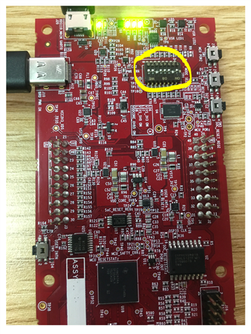

  • Hi Duong,
    Looks like you have set the boot mode to QSPI which is not the boot mode for flashing the initial binary (SBL_NULL) into the on board QSPI flash. Please refer to the following URL: https://software-dl.ti.com/mcu-plus-sdk/esd/AM243X/08_01_00_36/exports/docs/api_guide_am243x/EVM_SETUP_PAGE.html#EVM_FLASH_SOC_INIT
    You will need to download and install the MCU+ SDK 08.01.00.36 from: https://www.ti.com/tool/download/MCU-PLUS-SDK-AM243X
    Ming

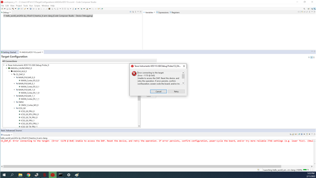

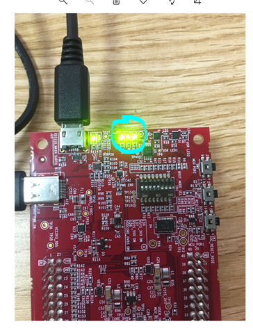

    Here are my process:
    1. Cable Connections: ok
    2. Setup UART Terminal: ok
    3. Flash SOC Initialization Binary: ok
    -->But flash SW to LP-AM243x still fail as text below
    "CS_DAP_0: Error connecting to the target: (Error -1170 @ 0x0) Unable to access the DAP. Reset the device, and retry the operation. If error persists, confirm configuration, power-cycle the board, and/or try more reliable JTAG settings (e.g. lower TCLK). (Emulation package 9.6.0.00172)"
    "Unable to connect to the target"
    -->Fail the same with both  boot mode config: UART and OSPI
    QSPI Mode                                                                                                                            UART Mode

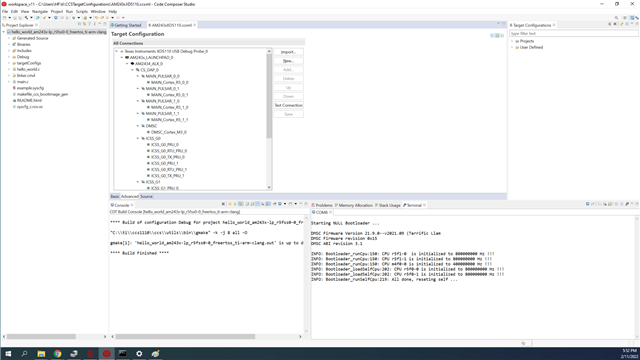

  • Hi Duong,
    Looks like you have flashed the initial SBL_NULL to the flash successfully.
    After that, switch to OSPI boot mode, then connect UART. You should see the following display on UART output:
    Once you see the correct UART display, then you can launch the AM243xXDS110.ccxml and connect to the R5_0_0 core. The paused address should be either 0x44 or 0x00, then you are ready to load your application code (like HelloWorld).

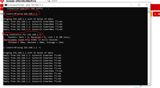

    Today i check the ethernet sample with the link on Resource Explorer:
    lwip:
          - enet_lwip_CPSW
          - enet_lwip_ICSSG
    They run well but i saw that the IP is always are: 0.0.0.0
    Here is the guide line from e2e.ti.com: software-dl.ti.com/.../EXAMPLES_LWIP_ENET.html
    • If you see a valid, non-zero MAC address but IP address is 0.0.0.0 then
      • Make sure you see link_callback==UP message, if not check the ethernet cable
      • Check the local network and check if the DHCP server is indeed running as expected
      • When using a home broadband/wifi router, its possible to check the clients connected to the DHCP server via a web browser. Check your router user manual for more details.
    -> You can see above image: "link_callback==UP"
    -> DHCP server  is OK via check gate way by web browser: http://192.168.1.1/
    -> LAN Cable is OK
    ->I also double check the IP range and LAN connection. every thing is ok.
    Can you explain for me: why ip always 0.0.0.0 instead 192.x.x.x
    I am sorry because i just start with program firmware for TI IC.
    thanks and best regards,
