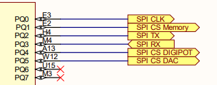

Hello, I have a custom board with the above uC and I need to use it to communicate with DACx0508. I saw that built in SSI module only allows for up to 16 bits of data transfer at a time however DAC requires 24 bits of data. I was hoping doing two calls to the peripheral function SSIDataPut() with 12 bits of data each time would do the trick but no such luck. I am assuming it is not working because there is something wrong with the SSI initialization and not because of the DAC. The way I am testing is checking the voltage after disabling the internal 2.5V reference of the DAC and seeing if the voltage changes to 3V. Here is the schematics and my code.

Schematic of the connections using SPI.

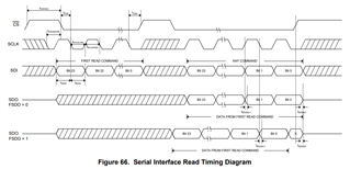

DAC Write bitfield specifications from DAC datasheet.

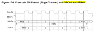

      I don't really see a problem with your SPICLK configuration which is 2Mhz. However, in order for the master and slave to talk, they must follow the same polarity and phase. You configure SSI for mode-0 which is sending data at falling edge and sampling data at rising edge.
    However, reading the DAC, it is sampling data at falling edge. You should change the polarity and phase to make both sides match.
