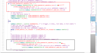

(2) For the following code, when the equality and inequality tests are performed, the check conditions of the diagnostic results are different, one is or |, and the other is & &, is it a problem with the diagnostic library code? thanks
    For equality test:
    • If the comparator matches (no true silicon fail), there is no status bit set for ADDR_COMP_LOGIC_FAIL or ADDR_DEC_FAIL.
    • If there is true silicon malfunction, ADDR_COMP_LOGIC_FAIL and ADDR_DEC_FAIL will be set.
    For inequality test, the compare vector will not match since non-inverted and inverted values of the same test vector are fed to the comparator:
    • If there is a silicon malfunction on any of the comparator bits, then, ADDR_COMP_LOGIC_FAIL and ADDR_DEC_FAIL will be set.
    • If there is no silicon malfunction on any of the comparator bits, then only ADDR_DEC_FAIL will be set. This is why the AND is used.
