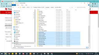

I am using TM4C1294KCPDT coustom board in my product . In my application need to transfer data from controller to USB pendrive . Please suggest me which example Should I follow in TI USB Example .

Hello Rani,
I would recommend starting with usb_host_msc.
The usb_stick examples are primarily for boot loading a firmware image onto the TM4C over a USB drive.
