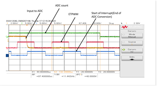

TMS570LS1224: Delay in ADC Sampled value - ADC sampled value is updated at the 2nd EPWM cycle where as it should have done it at 1st EPWM signal.
