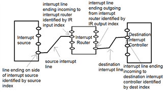

    The way I understood it was that the local subsystem is that near to the source peripheral while the remote subsystem is that near the destination interrupt controller. As I also read in the TRM for the interrupt aggregator that there are local events like for instance edge changes at source perhiperal pins.
    And there are global events as messages on an ETL.
    So I was also viewing it in the interrupt router context that the local side would be ment as the source peripheral.
    But that does not seem to be the case.
    It is probably described from the view of the interrupt router.
    There are interfaces provided by the interrupt router that are accessed by the destination interrupt controller.
    Those are local interfaces inside the interrupt router.
    And then there are remote interfaces provided by external source peripherals that are used by the interrupt router.
    Why I see it like that is because when looking here

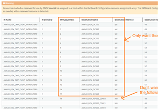

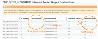

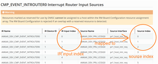

    Sciclient_rmIrqIf in drivers/sciclient/soc/am64x_am243x/sciclient_irq_rm.c, line 202ff.
    I should have asked this earlier, but what does the 'ff' indicate at the end of the line number? Do you mean line 202? I can't find a comment on line 202. I looked in sciclient_irq_rm.c for MCU+SDK 08_01_00_36 & 08_02_00_12. Can you please share the comment itself?
    tables concerning IR input index to source index
    tables mapping IR output index to destination index
    For example, these tables, correct?
    Frank

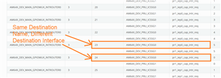

  • Hello Frank, thank you for taking the time to review and test the code.
    Concerning your question what tables I am talking about.
    Right, on this page
    software-dl.ti.com/.../interrupt_cfg.html
    there are several tables.
    Some of them are mapping interrupt router input index to source index, like this:
    and then there are those which map IR output index to destination index, like this:
    And as I understand it, the interrupt routing works like this:

    Concerning the resource ranges, in the GPIO-mux-table I thought that the right output range can be found simply by providing the secondary host ID, as in your example
    the type was the device ID of the interrupt router and the subtype would only say that the type is for an interrupt router.
    So the range could only be fruther restricted inside the interrupt routers output table by the secondary host.
    Which would, as I understand, tell the TISCI-API which is the target interrupt controller,
    but for instance for MAIN_GPIOMUX_INTROUTER0, let's say I want only those for AM64X_DEV_PRU_ICSSG0 pr1_iep0_cap_intr_req I don't see how a secondary host ID would help me here. As far as I see it, I could only get the whole range for
    AM64X_DEV_PRU_ICSSG0 over all destination interfaces, in this case pr1_iep0_cap_intr_req and  pr1_iep1_cap_intr_req
    I am still looking for a way, let's say for instance only to get the resource range for AM64X_DEV_PRU_ICSSG0 pr1_iep0_cap_intr_req.
    And as I see no connection between secondary host ID and the combination of destination name and destination interface.
    It is commendable that you say the user of te SDK should not have to look into the code, but apparently I have to, since either functions that I'd like to use are not exposed or the functionality that I desire simply doesn't exist.
    My understanding of the Secondary Host ID is it allows a Host to configure an interrupt route for another Host. Without using Secondary Host, an interrupt route can only be configured for the Host making the request. However, I need confirmation this from an Sciclient/TISCI/SYSFW expert.
    Resource ranges (IR Output ranges) are assigned to Hosts, see https://software-dl.ti.com/mcu-plus-sdk/esd/AM243X/08_02_00_12/exports/docs/api_guide_am243x/RESOURCE_ALLOCATION_GUIDE.html.

    Now in the above example one could simply think that the intr interface has a different Destination Name than the spi interface.
    But I checked that this is not always the case.
    For instance in the MAIN_GPIOMUX_INTROUTER0 output table we find
    So we need the combination of both to clearly define the range.

    there are ranges of outputs grouped by the combination of IR Device ID + Destination Name + Destination Interface.
    But when I do the Sciclient_rmGetResourceRange() call I get the output ranges as a combination of IR Device ID (type) + Host ID, (subtype is always interrupt router output).
    Now how does "IR Device ID + Destination Name + Destination Interface" translate into IR Device ID + Host ID ?
    For example:
    Let's assume I want the range of all output index numbers for
    Interrupt Router: AM64X_DEV_MAIN_GPIOMUX_INTROUTER0
    Destination Name: AM64X_DEV_PRU_ICSSG0
    Destination Interface: pr1_iep0_cap_intr_req
    I would expect the range of the following output index number: {18, 19, 20, 21, 22, 23}
    In the Sciclient_rmGetResourceRange() function I could provide the IR device ID of AM64X_DEV_MAIN_GPIOMUX_INTROUTER0, which is 3.
    But since the only other variable parameter (subtype is not variable as it is always TISCI_RESASG_SUBTYPE_IR_OUTPUT for every interrupt router output) I can provide to further specify the range is Host ID, then how would I get the resource range for
    by specifying a secondary Host ID?

    As I am coding in C++, I created an InterruptRouter class. which depends on several template parameters.
    I want a Singleton InterruptRouter object that only exists once in the system.
    But I don't want it to include all interrupt routers and all the inputs and outputs of all the available interrupt routers.
    I want one object for every combination of "IR Device ID", "Destination Name" and "Destination Interface".
    That object should only manage the INTR outputs of one such combination.
    Normally I would have an interrupt source which is to be connected to a destination interrupt controller.
    In my understanding I need to find the right interrupt controller input line that is ment for this kind of interrupt source.
    The interrupt lines of the destination interrupt controller used in the routing are hardwired to the output lines of the interrupt router, as I see it.
    So to find the right interrupt input line of the destination interrupt controller, I need to choose one with the right "Destination Name" and "Destination Interface" in the resource table here
    https://software-dl.ti.com/tisci/esd/latest/5_soc_doc/am64x/interrupt_cfg.html#am64x-interrupt-management-device-descriptions
    Now let's say that I want to connect a GPIO over the interrupt router MAIN_GPIOMUX_INTROUTER0.
    Let's assume that the user wants to connect to R5F Core0, and directly connect the interrupt router to the destination.
    So the following configuration for the interrupt router output range would be correct:
    IR Dev ID: AM64X_DEV_MAIN_GPIOMUX_INTROUTER0,
    Destination Name: AM64X_DEV_R5FSS0_CORE0,
    Destination Interface: intr
    Now there are INTR Outputs 0-15 for this configuration.
    The user probably doesn't care which one is used. All they want is to connect to one of them.
    Also they will most probably not know which one to use, as other users might want to connect their sources as well without
    having to look into a global table which of the outputs are already chosen by others.
    So the preferred solution for me would be, that inside my code I use something like the Sciclient_rmGetResourceRange() function to get the range of interrupt router outputs that are applicable for the source that the user wants to connect to the destination interrupt controller.
    I would preinitialize my InterruptRouter class with that range according to its template parameters as stated above of "IR Device ID", "Destination Name" and "Destination Interface". As there is no exposed function to find out which INTR output is still free, I will probably have my own list, where I assume that on system start all routes are still free.
    And then, later on, when a user asks to connect his interrupt source over the interrupt router with preset "Destination Interface" and "Destination Name"I would just connect the source over the next free interrupt output, which I get from the list initialized from the resource range. Afterwards I would tell him the destination IRQ number (which is the interrupt router output that was used translated using the Sciclient_rmIrqTranslateIrOutput function).
    That is what I want.
