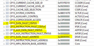

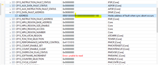

    As per recommendation below is the respective code generated in the project. I observed the " vPortRTOSRunTimeISR" ISR is executed couple of times but after that the code gets stuck at dataEntry.
    dataEntry
    b dataEntry
    Can you please take a look if there any bug or the use of "portGET_RUN_TIME_COUNTER_VALUE" function.
    Kishor

    A Data Abort Exception is a response of an invalid data access. If the exception is confirmed to be a Data Abort, as the first step, check the value of the Data Fault Status Register (DFSR) of the Cortex-R CPU. Please find the value of the status registers:
  • the status register as in below image.
  • Can you please help me to identify the exact issue and its solution?
    Kishor

  • Hi Kishor,
    The data fault address is 0x0808000C which is out of the valid range (0x0~0x0807FFFF). You need to figure out why your code accesses this invalid location.
     privilege mode is all other modes except user mode. It is in system mode by default if using HALCoGen generated code.
